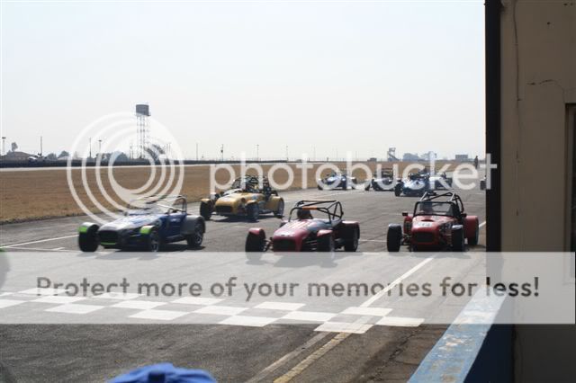

Lotus Challenge Race 1:
I was lined up surrounded by those dreaded 20V’s class B cars ;), and I knew they were going to be in front in turn 1. Fred was behind me and I was going to be happy if I just kept him behind me. Paul next to me really launches his car well, so I knew he would be in front, and I thought I would try and dive in behind him and try and follow him closely. Lights out and we were off. Lauren (in front of me) didn’t get a good start, and I had to go left to avoid her, and I pulled in next to her. Apparently the marshals didn’t like this, but no-one said anything afterwards, so I guess they figured out I had no choice. Once Lauren got up to speed she pulled ahead of me again and I fell in behind her. Gary had a good start and was in front of Lauren, but through turn 2 and 3 Ken and then Paul got past me as they had the inside line. The snake now more or less straightened out, we went onto the back straight. They pulled out from under me a bit, and one of the other guys starting from the back with an obviously stronger engine passed me on the straight and also passed Paul into turn 6. I caught up with the pack a bit and pushed hard through 6 and by the start line I was about 8 car lengths behind the pack. I caught up to Paul under braking for turn 1 and was on his tail through 2 and 3. On the back straight Paul left me behind again and I had to fight hard to try and sort of keep up with them. The next lap going into the back straight, turn 5 which is a real crappy turn, someone had gone a little wide and off into the rough, giving me the opportunity to catch up, and the pack with me in tow passed him. With their compromised run into the back straight, I managed to stay with the pack, and Paul made his move past Gary at the end of the straight, and I went into the turn early with a compromised line trying to stick my nose into the gap between Gary and Paul. Paul had gone through but Gary still had the better line, and pulled back up in front of me with a better drive out of turn 6. I followed Gary for the rest of the lap, and on the next lap through turn 1 I had to let the stronger car through again. I followed him closely into the back straight and Paul caught a bit of a wobbly and he and Gary didn’t get a very good run down the straight. I tried sticking to the stronger cars’s tail but he just pulled away. It did give me a good run and I managed to keep the gap between me and Gary down the back straight constant. I caught right up under braking for turn 6 and was up close to Gary. Ken must have had a slide or something because Paul and Gary passed him going into the horseshoe. I managed to stick with them until turn 1 when Gary went wide and Ken snuck through on the inside. Unfortunately Gary recovered and slid in behind Ken and I had to try and stick to his backside. Through turn 6 I again tried my luck as I saw Gary going wide, but he closed the door and I kept on the pressure. I outbraked Gary into turn 1 hoping he would go wide again but learned from his mistake and closed the door. My only chance now was to try turn 6 again. I kept on the pressure and managed to keep the gaps down the back straight more or less constant, as I got a great run into the back straight. I was late on the brakes for turn 6 but Gary was late on the brakes also. I dived to the inside again but Gary closed the door. He went a bit too wide though, and gave me the opportunity to get the power on before he could, and I took a tight line going into the short straight to the horseshoe and I was next to him. He pulled back and went right and then saw I was next to him and he must have gotten a little fright because he pulled back left and managed to lose control and spin it. For a moment I felt bad as I saw him spinning and hoped he didn’t damage his car(which he didn’t). I now had my sights on Paul and Ken having a battle and I was hoping they would slow each other down. I kept on closing the gap and Klippies came past to lap us. On the back straight James also safely passed us, and going into the horseshoe we passed Anton G and I was back closer up on Paul. Through turn 2 I had to back off a bit and I got a good run through 3 and 4 to stay with Paul. Through turn 5 I managed to latch onto Paul’s back and he gave me a good pull down the first half of the back straight and then pulled out from under me a bit. The rest of the lap I followed Paul fairly closely and the next lap into turn 2 I stuck the nose in close to let Paul know I was there ;) I got a pull again down the back straight and the battle was now between me and Paul, with Ken having pulled a gap by now. Glenton passed us and going into the horseshoe me and Paul was taking very strange lines to attack and defend  Good fun! Into the main straight we got the flag and the race was over. Hard work but SO much fun! I crossed the line 0.4 of a second behind Paul and 5 seconds behind Ken.
Thanx to Johan for the pics:
