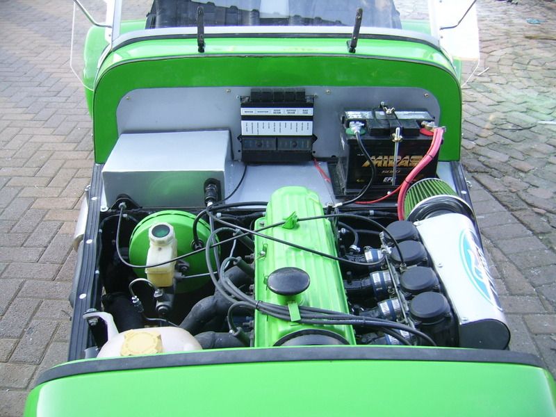

I decided to go old school to keep to the ethos of Lotus by keeping it Ford. I used the Sierra 2.0l Pinto engine - sump and oil pickup shortened not to hung out under chassis, the flywheel lightened from std 8.56kg to 4.9kg. a decent 4 - 2 - 1 exhaust branch build and mild cam. I fitted ZX9 bike carbs with custom made intake manifold and what a car my latest Seven turned out. That engine revs like a bike, fast and with no hesitation, no doubt the work of the constant velocity (venturi) ZX9's carbies. I accelerate from standing start to measured 90 meters and get the GPS on 105kph ( in 3rd gear already! having hit 6500 rpm in second gear)
The beauty with old school is as such, engine uses magnetic distributor with an ignition module and thats that. No expensive engine management and dyno tests (read expensive / destructive) to tune engine, easy to set timing and to balance the bike carbies - everything you can do yourself and best of all, dropping the cambelt a simple matter of fitting another because its a non-interference motor. Best of all, to get the power I make, really cost peanuts. These engines are cheap, spares as well...
I considered the fitting a 4AGE 20v but after driving a buddie's car, decided against. I do not like to rev a motor to dead to make it come alive and torque a bit crappy on the lower end of revs.
Building a street legal Seven one have to look at what is lekker on the roads and not racing circuit. Believe me, when you do it a second time around, you think differently and only then you woke up and smelled the roses :wink: Been there and done that...
Here are some pics of the Pinto engine in my new car.

Hi Wynand
What a beauty! No more engineering or craftmanship, but pure art. Well done!
